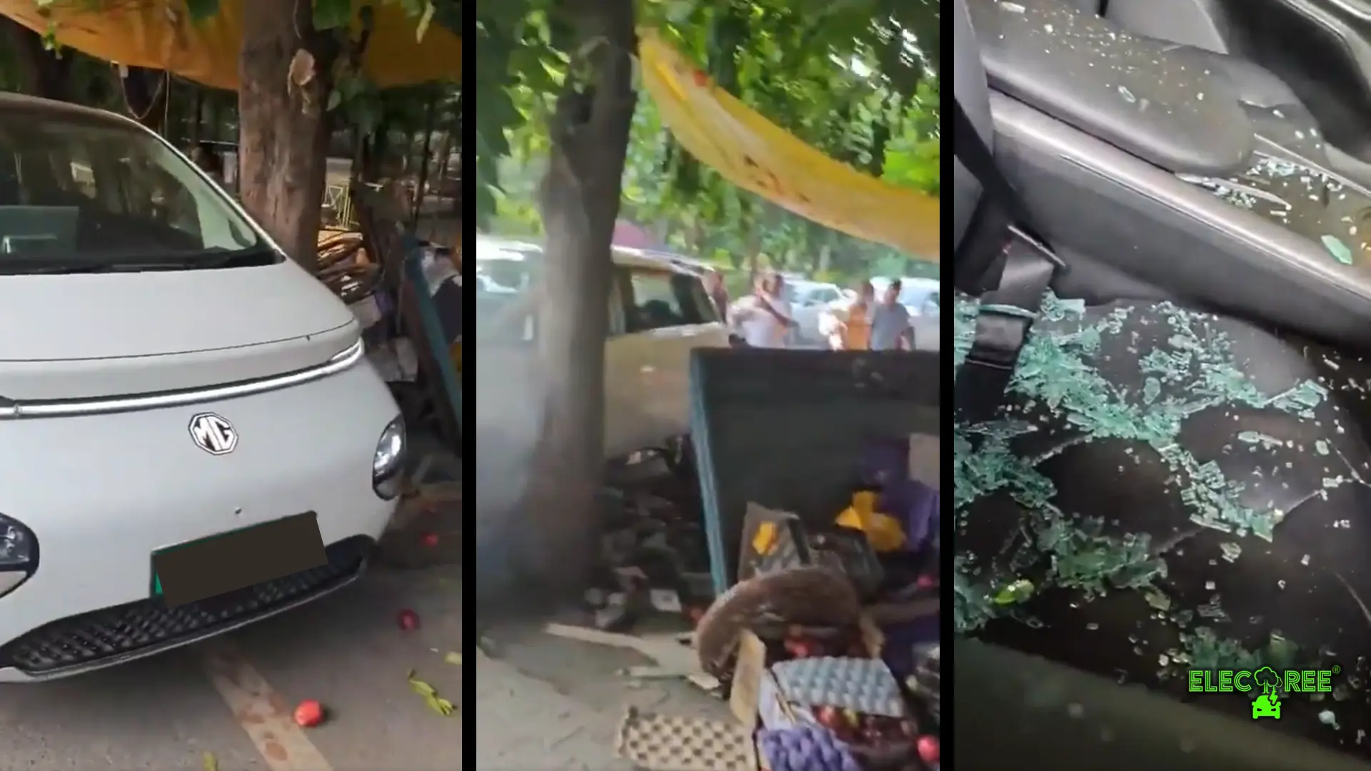

A video circulating on social media shows an MG Windsor rolling forward on its own after being parked in Ludhiana, crashing into a roadside fruit cart and then a tree. The seatbelt sensor and key-fob proximity check, not a fault unique to MG, appear to be behind it.
A video doing the rounds on social media shows an MG Windsor moving on its own after being parked by its owner, eventually crashing into a roadside fruit cart and then a tree. ElecTree has found that the owner is from Ludhiana. We are withholding his name for privacy.
In the video, he can be seen running alongside the car, warning bystanders to clear the way as it rolls forward uncontrolled. After it got stuck against the tree, he wedged stones under the tires himself. The driver's door wouldn't open, so bystanders helped him break the driver's window, reach in, and shift the car into park. The rear does not show the ADAS badging which rules out any automatic intervention which could have prevented this.

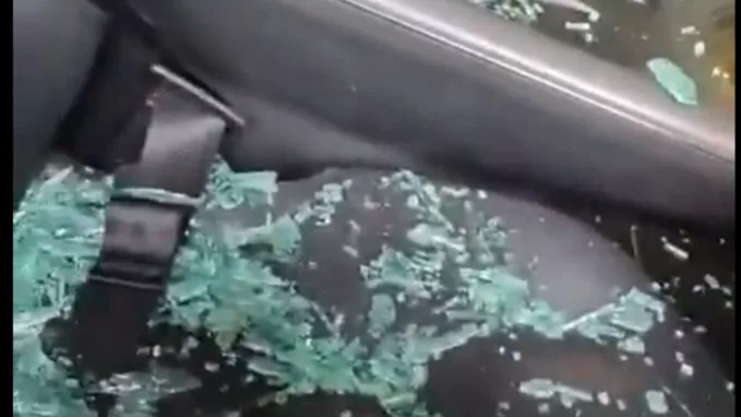

Once the window was broken, the seatbelt is seen still buckled, with no one sitting in the driver's seat. That single detail explains the entire sequence of events.
The Windsor doesn't have a physical start-stop button, it relies on the key fob's proximity and the seatbelt sensor to judge whether a driver is present and ready to drive. When the owner opened the door to step out, the car applied its electronic parking brake automatically. When he closed the door again, the belt still read as buckled and the key was still in range, and since Drive was the last active mode before he'd stepped out, the car appears to have inferred a driver was present and ready to go. Without a start-stop button forcing a fresh, deliberate re-engagement, it released the parking brake and resumed creep in drive on its own. Because the owner ran alongside trying to stop it, the key stayed within range the entire time, so the car's proximity check kept being satisfied and it never received a signal to stop. Since the car assumed driver was inside, as a precautionary measure against theft, it did not allow opening of the door from outside.
